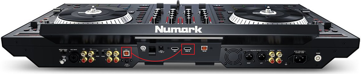

  2. Disconnect the USB cable from the Main NS7III unit from the display (highlighted below)
