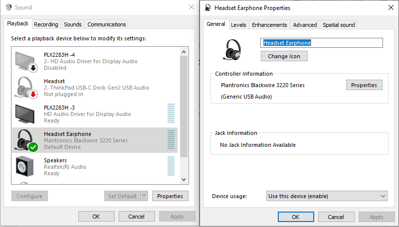

Right click this and select Sounds, this will bring up the Sound Control panel where you can see all the devices previously connected for both Playback & Recordings tabs.
Select the device you want to use and make sure this has been set as the Default device. Then check that the device usage is enabled. See below:
Once confirmed this should now be selected as your Playback device.
